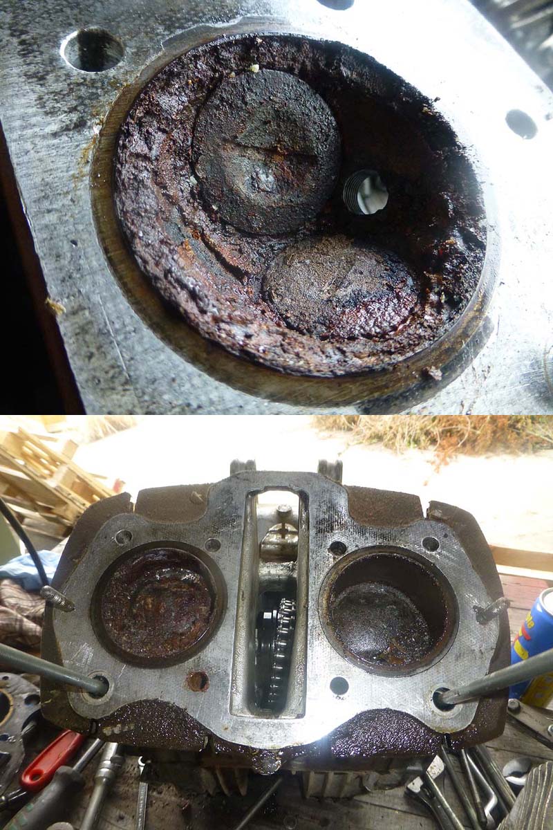

As I expected, the domes were pretty rusty.
Image20171112_155357 by kenneth zukowski, on Flickr
After brushing away the rust, I found that one exhaust valve landed open so the valve and seat most likely toast. Your opinion most appreciated, Ed. I don't have the experience on valves. If all valves were closed I would be tempted to blast this head clean, then do a static leak test to see how much they leak and hope for the best. At least I have cams etc. to play with. Rusty

modelman
Posts: 222
Location: Yorkshire, UK
Post by modelman » Mon Nov 13, 2017 2:41 am
Do you think there's a fundamental design flaw with these engines?
The reason I ask is that there's been many almost identical cases where this has been found, & i've also noticed that even when advertised it states either 'seized' or 'not seized' which suggests it common!!
I was very wary as to the fragility of the cases so didn't attempt to 'bash' them out so I jacked them hydraulically with grease.
I've renovated many old engines & none rusted up like these, maybe its the grade of materials used??
