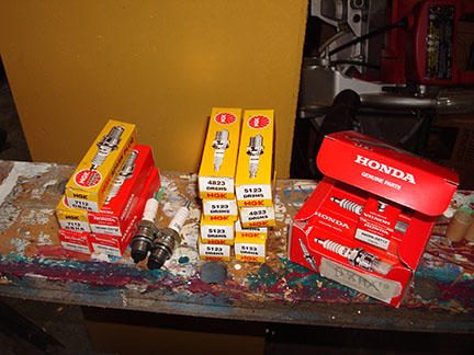

Been fiddlin' for months now...no matter what I try, my plugs foul in just a couple minutes.
This has made for a considerable cost in spark plugs...
I have waffled between this being something in the electrical ignition, and something in the carb. After replacing everything in the ignition (points, condenser, plug wires, plug caps, coil, ignition wires), I put the blame on the carb. Even after trying every possible setting for float and needle, I'm mostly-sure this is where my troubles lie.
But I had to figure this out the hard way. SEVERAL of the parts I have ordered for my Dream have been wrong (many people obviously send stuff for a CB77 thinking it's the same). The non-resistance thing in the plugs is particularly challenging...more than one NGK plug dealer has given me 'DR8HS' plugs 'coz their books show it as replacement for 'D8HA' (pile in middle in photo). It's not a replacement, it is the resistor type!
Anyhow, I've done it so often now I'm pretty sure my float height is good. I have a 120 main jet; both the jet and the needle are from my old carb as the replacement Keyster brass does not look good. I've had the needle in all settings, latest with it fully 'in' on its top notch. With new plugs, I have good spark, and the bike starts up right away (no choke), then runs great for about 2 minutes...when it stalls because the plugs are fouled as black as coal.
When running, it has no odour of burning oil, but makes a light-grey smoke that gets steadily worse. By the time it stalls there's quite a bit of grey smoke, which I'm presuming is unburnt fuel.
My Dream is a non-USA model C77. When I got it, it had a Mikuni VM22H carb on it, which is not correct (I think) and had a epoxy repair to the set screw housing. It would foul plugs, but over a matter of hours, not minutes. I got a Keihin off Ebay, seems absolutely kosher and clean.
Anybody have any advice or suggestions for me?
