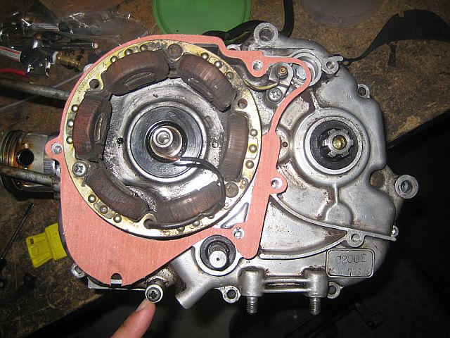

Now, the next step involves putting the 2 crank case covers back together. The only problem is that the micro-fiche I have doesn't illustrate the size of bolt I need to put the halves together. I measured the original ones at M6 x 60mm, but there are a few shorter ones. It looks like there is a total of 9 that go around the case. 1 or 2 of them may be shorter than 60mm and I don't remember where I took the original ones out from.
Take a look at my finger pointing to the bolts I am desribing for the crankcase cover.
Does anyone have a reference for the quantity and size of the bolts required to rejoin the crankcase halves? The torque settings would be good too.
Thanks
My finger is pointing to one of the bolts I need the sizing for.

Post by 4shorts » Fri Jul 24, 2009 6:09 pm
I wish I had a service manual to help you but I don't. If I were you I would just measure the depth of each hole and then match the bolts that should go in eash hole. Here in Newfoundland if we don't know the proper torque we just say " put'em in a grunt and a half".
