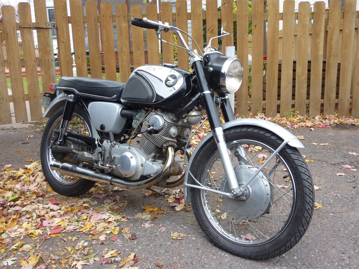

Here are a few pics
here it is right off the truck
here is where it sits today

Nice bike, welcome the forum, lots of good info here. Your forks and seat mean it is earlier than 68. Good score!! Having the center stand drop down around a curve, must have gotten your full attention, ha?

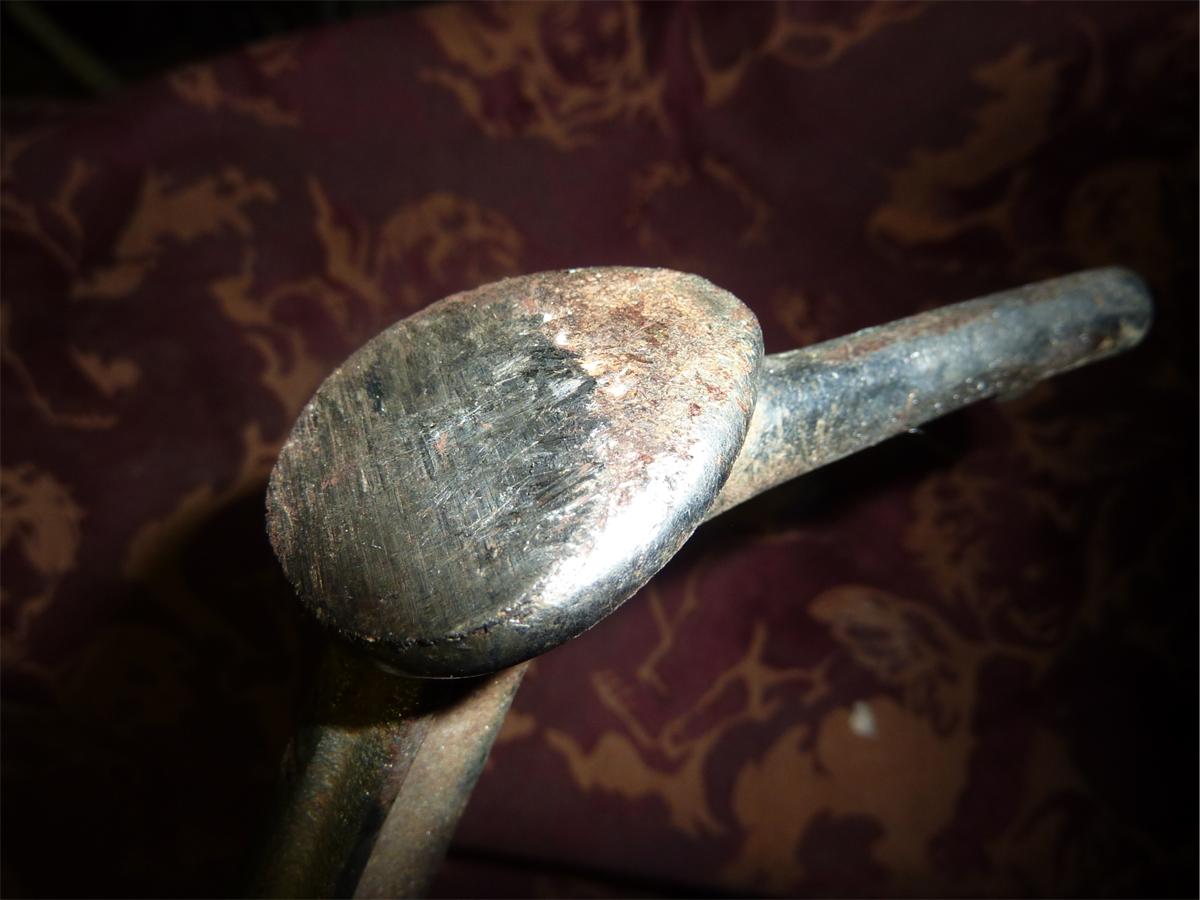

Here is a photo of the bottom of the side stand after the incident. I think the mounting plate was bent which might have caused the issue...this also allowed the bike to lean over much farther increasing the excitement. There will never be a side stand on this bike again!

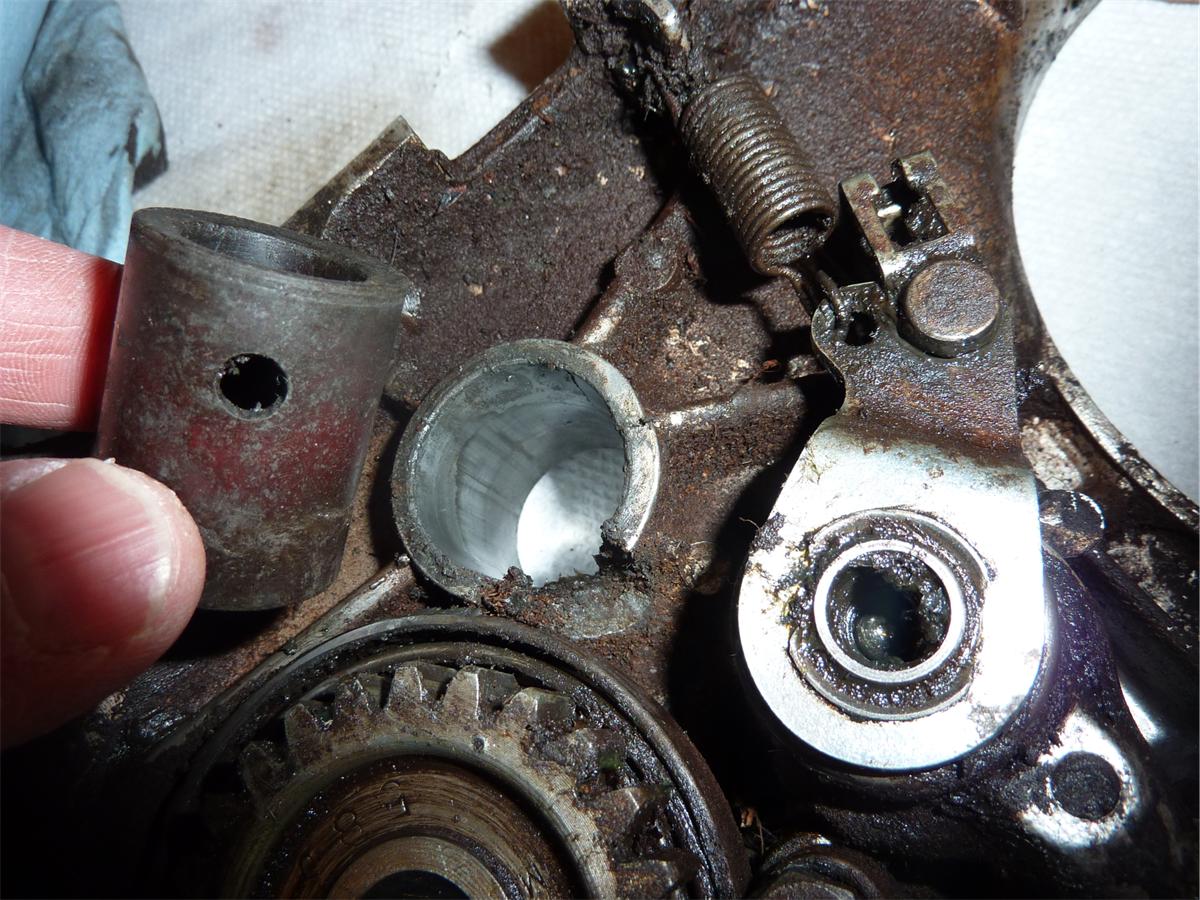

One of the most obvious issues with the bike was a wobbly kick starter. Why would they ever put a plastic bushing to support a stubby kick shaft.
After removal of the side cover I could see the cover was broken around the bushing allowing the excess play at the shaft. The old bushing was easily removed by putting a metal washer over the bushing and gently tapping towards the broken side of the cover with a hammer and a brass punch.
I am going to get some bronze bearing stock and have a new bushing machined to fit. I'll repair the broken cover with JB weld. I think this would be a worthwhile upgrade for everyone.

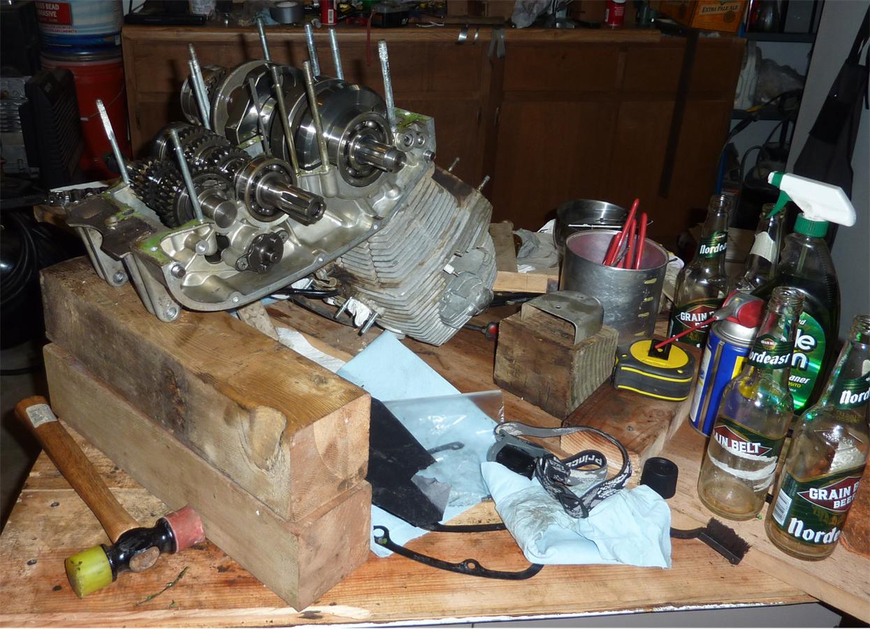

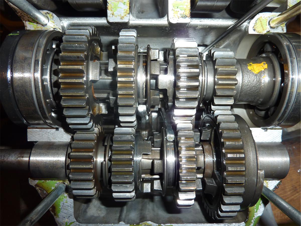

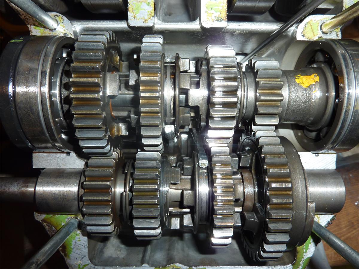

When I got the engine cases split the problems were obvious. The bushing at 1st gear on the counter shaft is shot allowing the gear to wobble a couple mm on the shaft. And the gear dogs on 2nd gear only engaged by about 10% of their area.
Luckily I was able to get a used transmission with the shift drum on ebay for a good price. The transmission looks like it has hardly been used. I am going to swap out the whole assembly.
Here is the transmission in 2nd gear with very little gear engagement.
