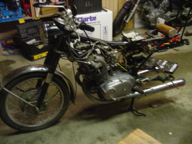

This is the earliest pic I have of the bike.  I had the rear wheel off to clean it.  I was a little scared to tackle too much at this point.  Wish I would have taken a complete pic before I tore it down.

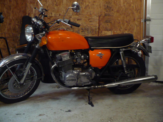

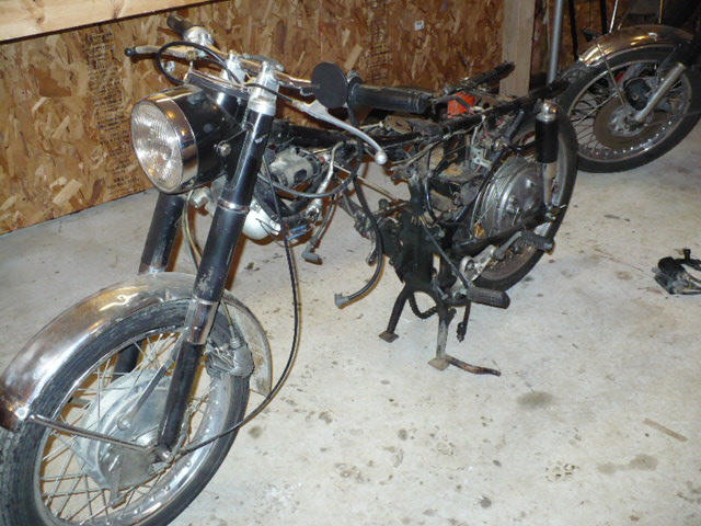

My 1974 CB750.  In need of a clean and polish.

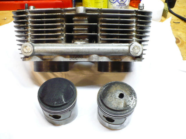

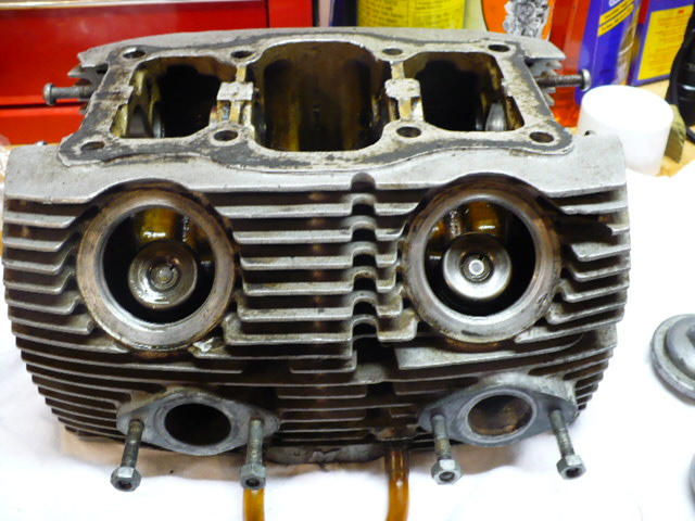

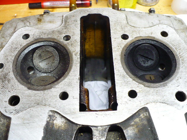

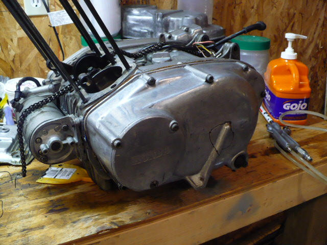

So now that I have the time and confidence to try and tackle the motor, I pulled it from the frame, removed the head and found a lovely hole in the left piston. I wasn't surprised. Based on what I had read I thought that could be causing the lack of compression.

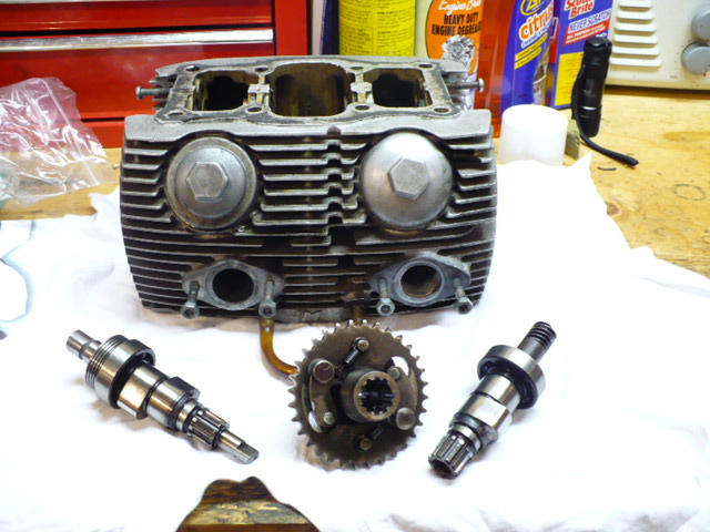

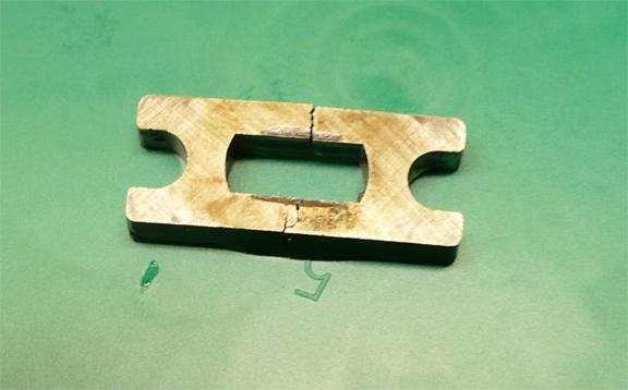

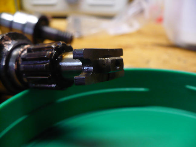

I wasn't sure if I was going to try to tackle taking the head apart. But after reading Bill Silver's manuals and checking out my cam sprocket I decided to remove the cam and repair the loose sprocket, clean the head and re-lap the valves. After lots of reading and too much time staring at the head on the bench, I finally was able to remove the camshafts. Unfortunately, I damaged the advance system in the center of the sprocket. So for all of you reading this I'm searching for that part (I've included a picture of this part:).
I've been trying to clean the parts with little luck. I've been reading the threads on sandblasting and borrowed a home-made sandblast cabinet from my father in law. He dropped it off today. It needs a little TLC before it's usable. But hey free is free. I've had the block to the machine shop and was told the first oversize pistons will be fine. If anyone has a set of pistons and rings for sale please PM me. I ordered a gasket set from Retrobikes today. So that's where I'm at. I'll get the blaster going, clean the parts and hopefully order my pistons/rings in the next week. Stay tuned and wish me luck. I think I'll need it.
Here's the pistons.  Can anyone tell me what causes this type of damage.  Is it from running to lean?  Can the valves cause this damage?
Got the Cam removed.  Sprocket rivets are really loose.  Will have to tack as per Bill Silver.

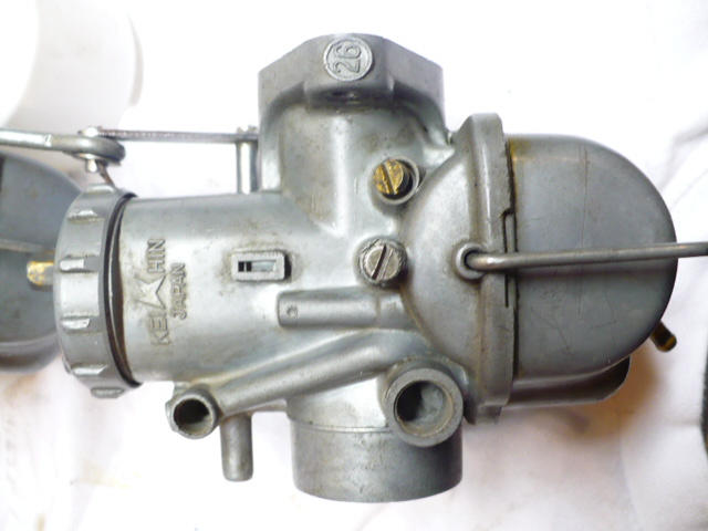

Here's carbs. I cleaned them up a long while ago. After reading 4shorts posts I think I'll give it another go.

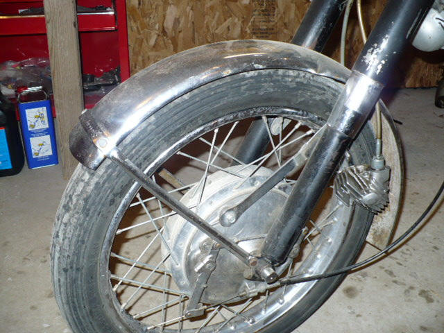

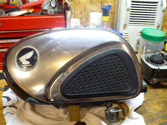

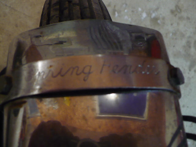

Misc parts. I've had some confusion as to the year of manufacturing of my bike (See my other threads). I'm hoping that these pics may help. I'll try and get a close up of the badges tomorrow. I'm not even sure if they're original.
Is this fender original?

Part Needed.
Post by youngjames » Wed Mar 25, 2009 11:59 pm
Here's a pic of the advancer part I need. It sits in the center of the cam sprocket. Anyone out there with this part?
Post by LOUD MOUSE » Thu Mar 26, 2009 5:04 am
After market front fender. What are the frame numbers? Get a new cam sprocket. The piston could be advanced timing that side/lean. .................lm
youngjames wrote:Misc parts. I've had some confusion as to the year of manufacturing of my bike (See my other threads). I'm hoping that these pics may help. I'll try and get a close up of the badges tomorrow. I'm not even sure if they're original.
