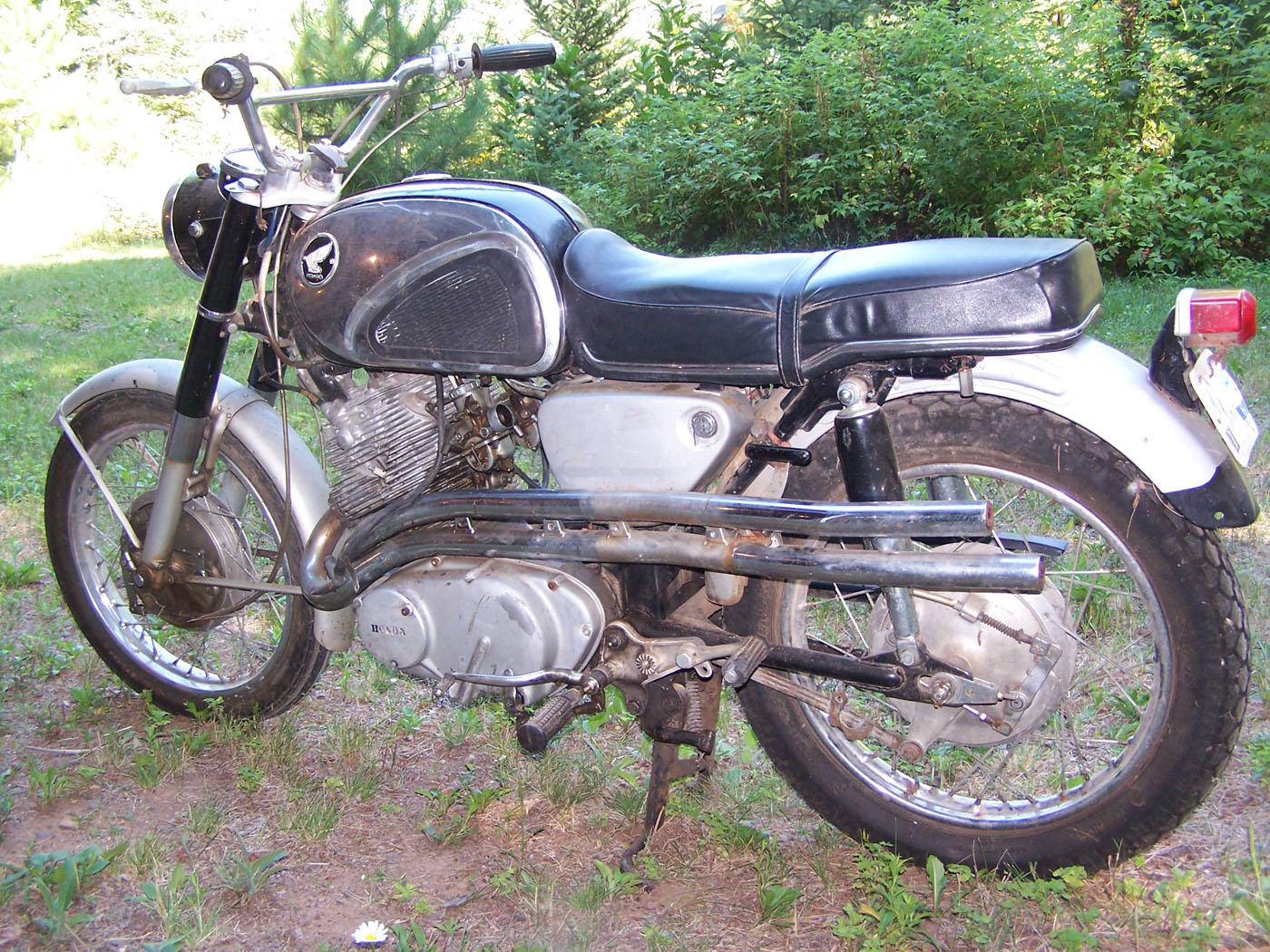

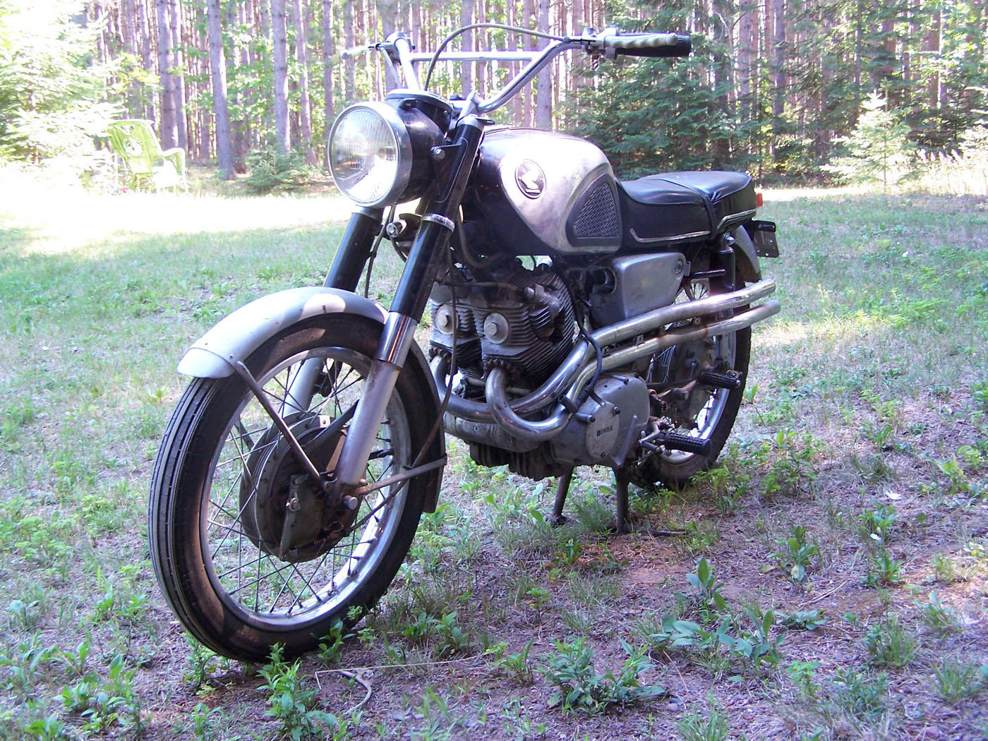

Okay! I am officially joining the ranks of the crazy. I'm starting to do a rebuild of a 67 superhawk that was left on my parent's property. The motor is seized and it's missing a few things. I have ordered the Bill Silver books, though they have yet to arrive. A few questions before I start...
1) What should I look for as potential problems?
2) Can I do this for less than $1000? If I'm just redoing the engine and electrical?
3) What sorts of paint schemes were used? I have access to free black powder coating (cat black), what about the tank and fenders?
4) How hard will it be to get parts/tires/etc?
Thanks for your help & enjoy the pics

From what I know, I believe that is a Scrambler not a Superhawk. But it still looks like it will be a nice ride and a fun project. Most of the parts you can get from ebay, and you can probably do most of the work yourself. I don't have any experience with motorcycles, and I am doing okay so far. But I did not have to rebuild the engine. There is a lot of information on this site that will help you on your way to a good restoration. Good luck on your journey!

looks like a superhawk with high pipes and enduro handlebars. someone enjoyed a terribly heavy dirt bike.

It's definitely a superhawk, based on the vin/engine numbers. I'm going to try and reuse as much of the current components as possible. I have to replace a few things such as the fuel cock body assembly and a bunch of hoses.
