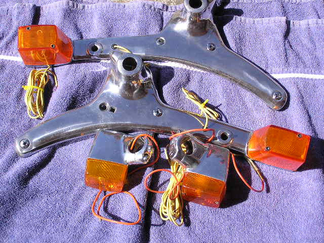

check this guy out at
http://fourwheelperformance.com/forum/s ... t=blinkers
his forum name is spokes
he did my rears and they look factory
