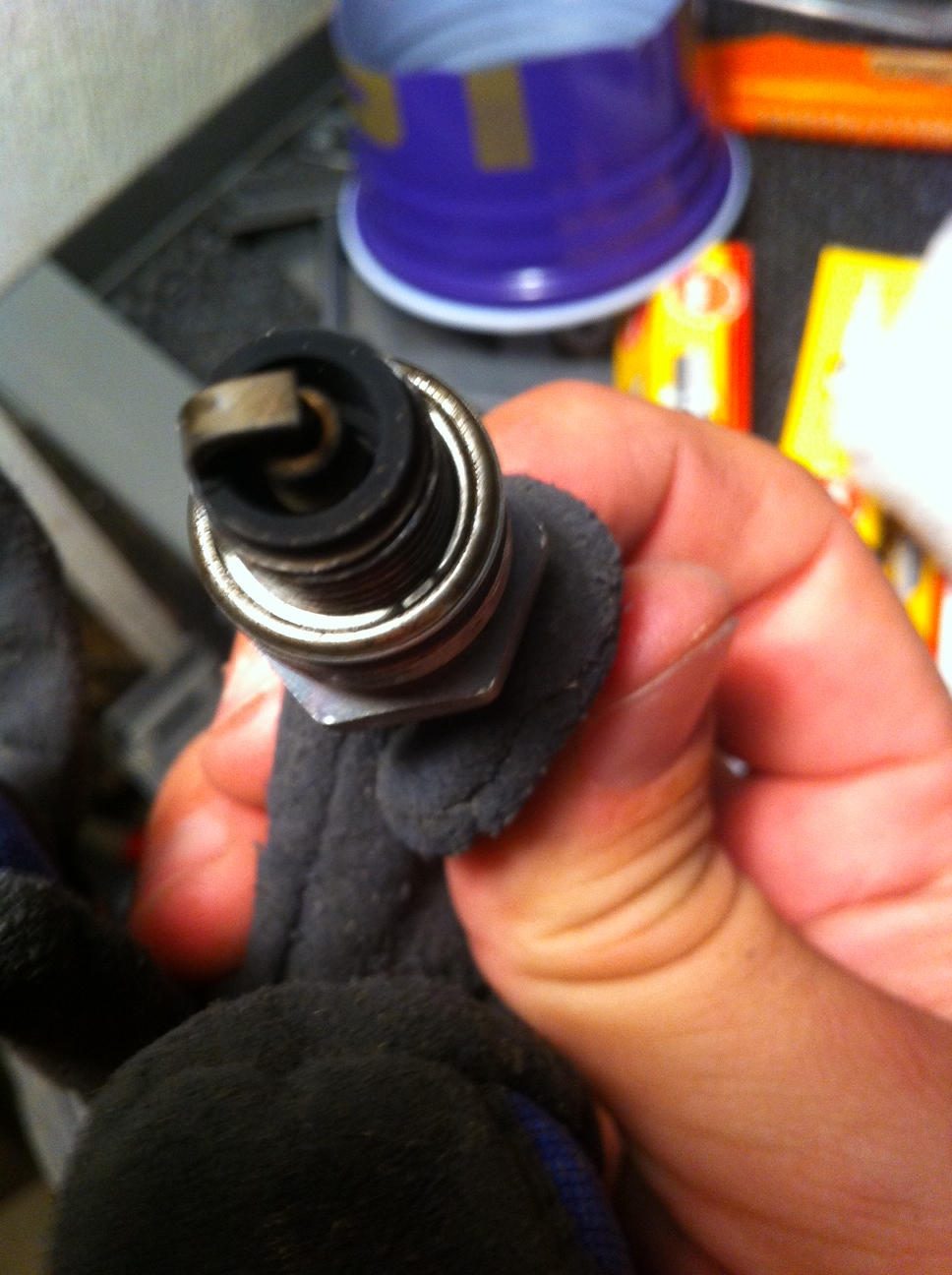

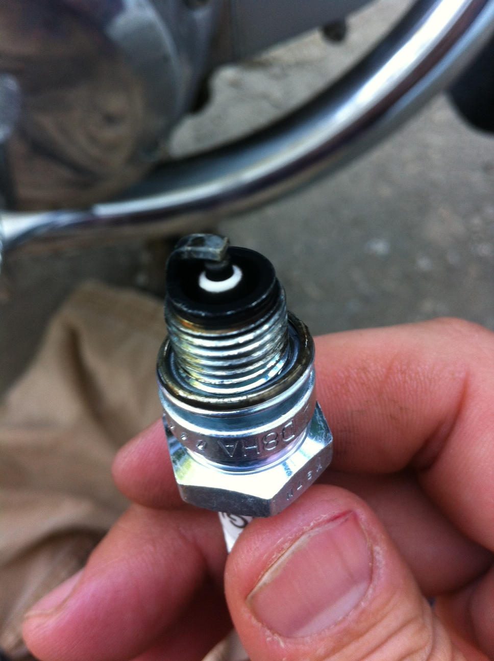

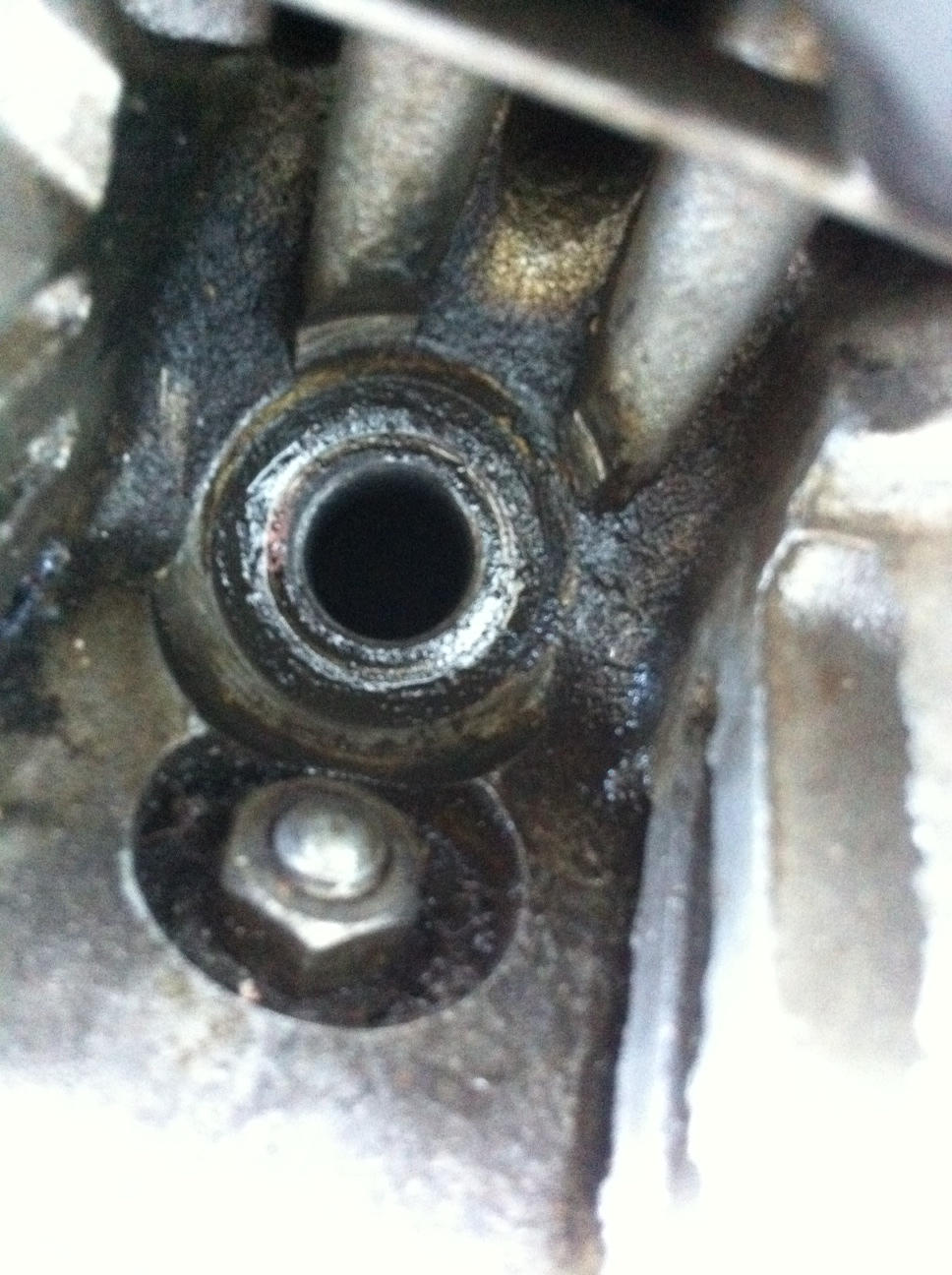

Of course, once something was tried but didn't work I would always go back to the recommended settings. I took the bike out last weekend and actually had a decent ride (about 20 min). After checking the plugs, I saw they were still fouled but not on the ground electrode like they had before. See attached image Spark-Plug-Before-Adjustment. Thinking I was almost there, I adjusted the float height beyond the recommended specs to lean it out a bit more. After doing so, not only did the plugs foul, but I believe it made it run lean. See attached image Spark-Plug-After-Adjustment. If this did cause it to run lean, than why is it still fouling? In addition to this issue, I noticed it was spitting out what appeared to be exhaust out of the breather hose on the top of the engine. I've never seen this before so I assume it was a result of the bike running lean? The only other issue I've noticed, is the area around where the spark plug screws in seems to always be wet. See attached image. I can't really tell if this is gas or oil but I would assume it's gas.

You may have symptoms of oil getting between the iron skull and the aluminum head casting. Have a look in Bill Silver's guide as this is a known problem on these bikes. It often shows up around the spark plugs...
Are you sure of the state of the rings / valve guides. The fouling you see may be oil as the centre electrode looks pretty white in your pics.
Just my two cents.....

No smoke from the exhaust, only from the overrun which I only noticed yesterday. Both the exhaust from the over run and the white on the spark plug were never seen until I over corrected the float to lean the bike out.
