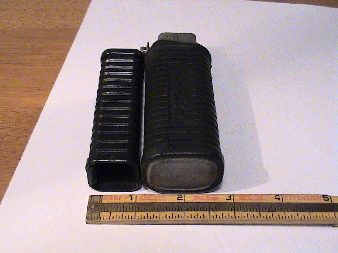

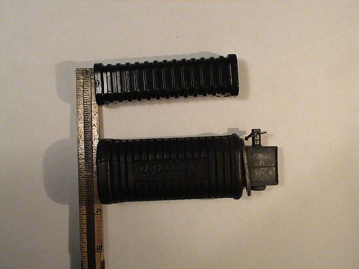

Just received these from Ebay seller, listed as part #95011-31000, NOS Honda part for CA77 Dream Touring.
SO....
either I don't have stock pegs on the back of my 66 CA77 (CA78-1019558)
or
these are for an earlier or later serial# CA77
or
these are not the listed part #
Attached are pics of my old pegs with the new rubbers.
Any help would be appreciated.

Post by JeffA » Sat Oct 31, 2009 5:18 pm
Sorry, can't give you a definitive answer, but here's what I can say...My 66 passenger pegs look exactly like yours. I've yet to truly understand how the various parts #'s in the parts catalog work, but the one you quote looks like a valid part # to me for at least some Dreams. My catalog lists 50718-257-000, 50705-024-000, and 95011-31000. Those rubbers are obviously wrong for the pegs you (and I) have.
Ohio Cycle has the 50718 for $45 each and the 95011 for $5 each. http://www.ohiocycle.com/catalog2.html
Jeff
Post by brewsky » Sun Nov 01, 2009 4:51 am
Jeff,
Thanks for checking!
The parts book is confusing to me too.
50718 and 95011 are listed for vin #'s starting later than mine
50705-024-000 shows no vin range but substitutes to 95011?
Does anyone have the smaller version on a CA77?
Thanks again

Post by G-Man » Mon Nov 02, 2009 5:32 pm
Hi
I have the large type on my 1963 CL72 and the smaller ones on my 1967 CL77.

Large posts
Post by 67305dream » Fri Nov 06, 2009 9:25 am
Hi, if anyone finds a source for the large ones, would you please post it?
I now have three sets of small ones that I can't use.
Posts: 5681
Post by G-Man » Fri Nov 06, 2009 12:43 pm
Ohio Cycle in their reproduction parts list.
http://www.ohiocycle.com/catalog.html
Post by brewsky » Fri Nov 06, 2009 3:00 pm
G-Man,
How do you know if these are the large ones?
