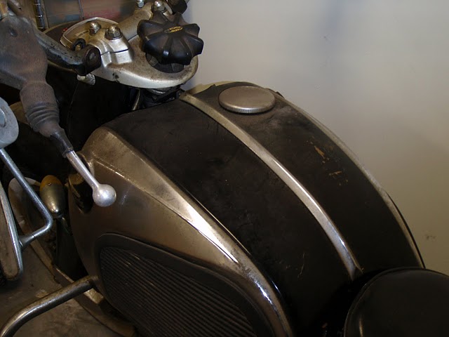

So, I was checking out the post by chugheshc on his 250 restoration. He has a link to a group of pictures and his bike has a late tank (seam and cap on right) with early chrome and rubber on the sides. I didn't check the parts book yet to see if the Honda literature supports this combo. If I remember right, the chrome piece on the seam was a 250 only item. Hmmmm.
Late Tank with Early side panels
