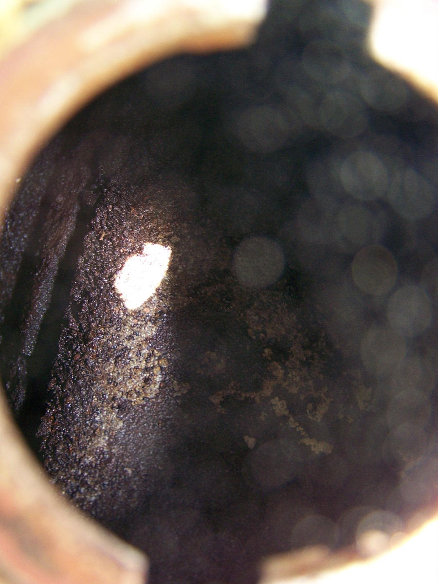

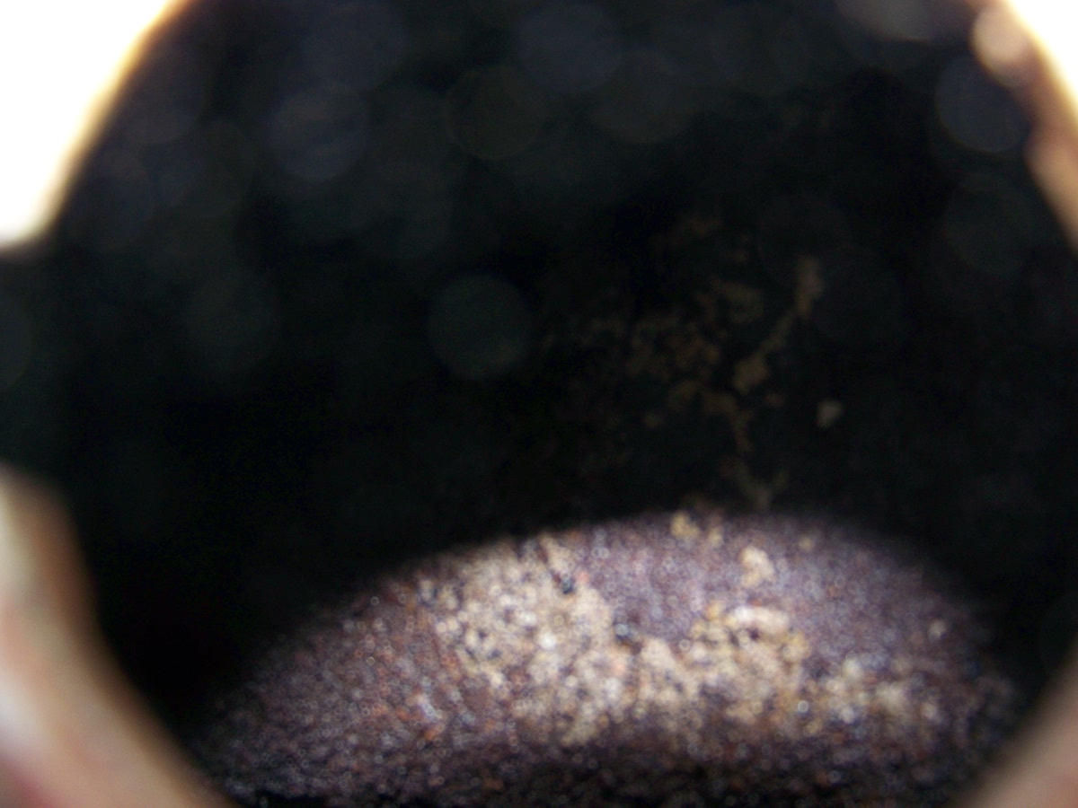

Hello folks i posted a question the other day about anybody tried metal rescue?? the you tube video looks great but the product didn't work very well ( and it's $35/4 liters), the vinegar and hot water actually worked better..so now i'm trying por-15,, the whole kit ... i would have posted before and after pics but camera was not taking very good shots of the inside of the tank.. i have some but there not great..hopefully the por is better... hopefully you can see the before shots..np

looks crusty :-)
I have the POR-15 system also based on reviews on this board and others. I haven't done it yet as I haven't started my build but am interested to see how yours comes out. Be sure to post pics and results.
