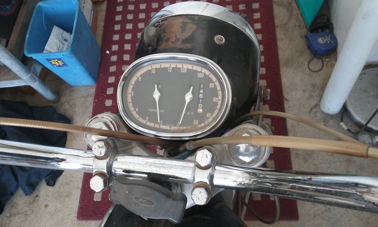

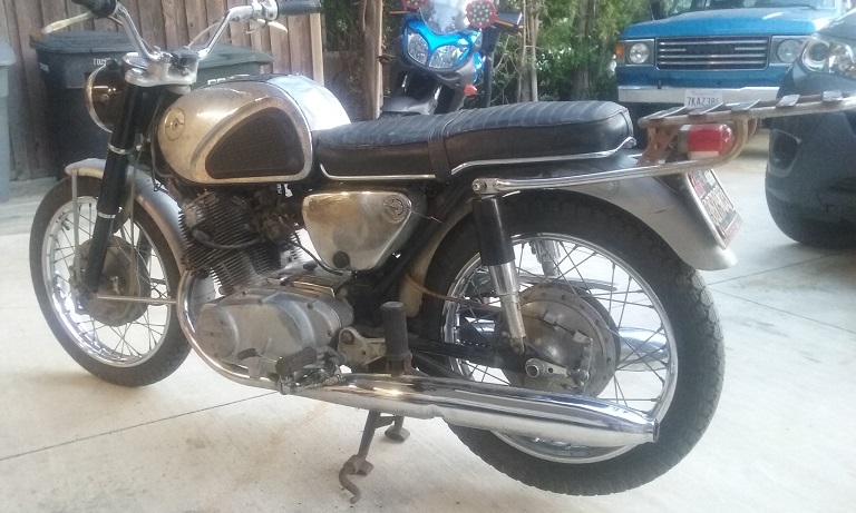

Here some pics..
Posts: 5681
Post by G-Man » Sun Aug 06, 2017 2:16 am
Great find!
The front fender seems to have been shortened a little but the bike looks in wonderful shape.
Just wipe it over, change the oil, clean the filter and you are away.
Very nice indeed.

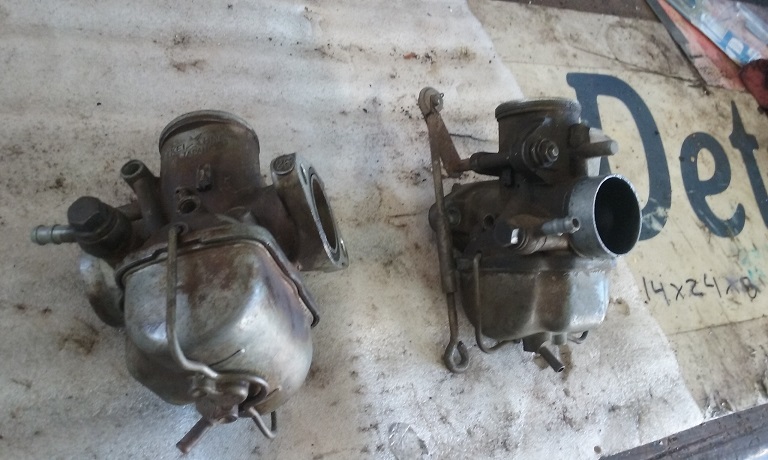

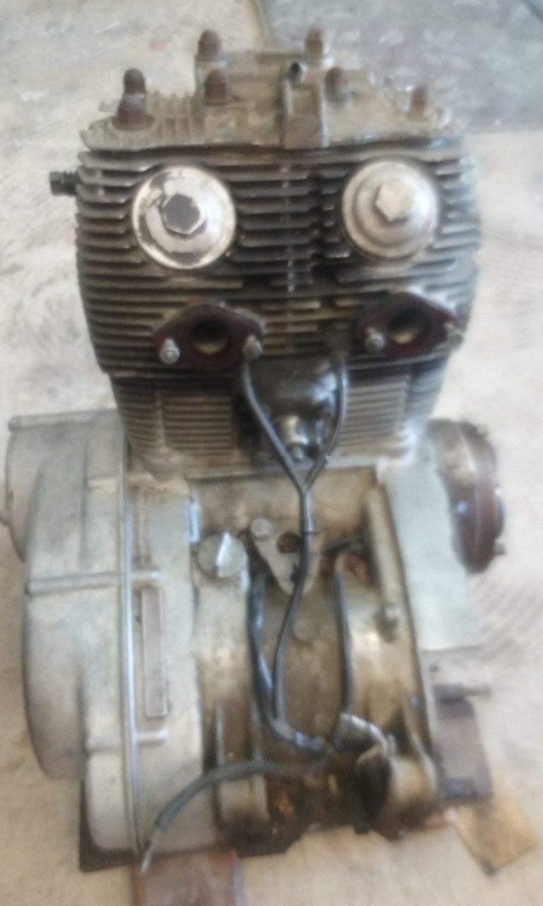

here is what I found when I open this baby..
one of the ring where stuck to the cylinder just enough to have me open the engine apart.
thanks to that I found the oil spinner was loose from the crank nut and there was no way it was going to work .
also I found the carbs where stuck.
but all and all it was good to look the inside of the components .
Here some pictures ..
I spend all day today with the magic of baking soda as a media blast ..worked really good ..!
Now im waiting for some new rings and timing chain.
