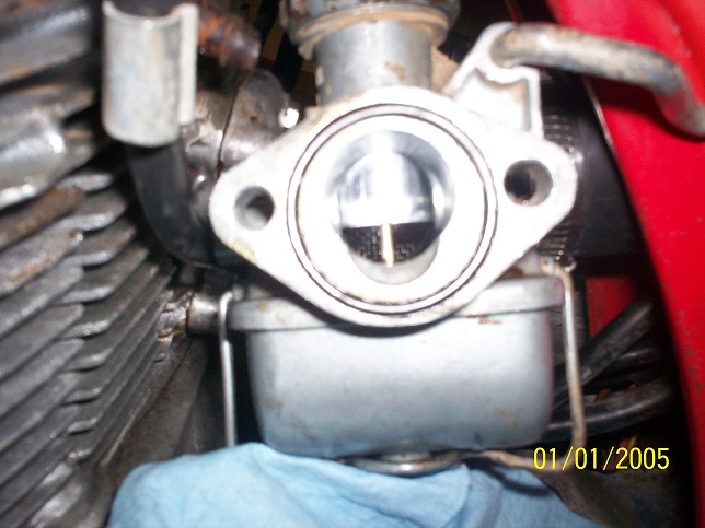

Sky high idle!Sky high idle!Hello! First time poster, but been reading and researching since the begining of the year. My 1964 CA77 has finally been running (with electric start!), but as soon as it turns over, it revs so high it's going shake it apart. I was worried about the odd throttle set-up on this bike, but the slide in the carb seems to move freely. Any suggestions/thoughts are welcome!
Re: high idleSecond that. It's a classic mistake, it probably has happend a few time for everybody who works with old carb. engine's ! When you have the carb slide in your hands, always put the 'long' slide-cut away from you, or, the little cut out at where your idle adjust screw is. 'Of course I've already taken a very modest position on the monetary system, I do take the position that we should just end the Fed.' - Ron Paul
