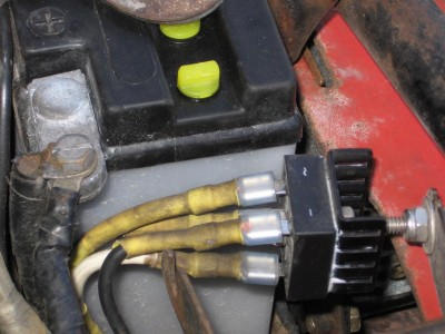

1. Replace the selenium rectifier! You are living in the 21st Century, and so should your electrical system. Get a full wave bridge rectifier from a place like Radio Shack p/n 276-1185 for about $3.30. This is the same diode sold on Ebay for $20!!! One of the nice things about this diode is the hole in the center of its housing, that can be tapped with a M6x1.0 mm tap to accept a 6mm screw. I mounted mine using a 6x16mm screw with a lockwasher and a flat washer on the right side tab where the old rectifier mounted to. You'll need to file or drill the slot abot 1mm bigger for the bolt to fit. I also used this bolt to connect the ground lead of the diode via an eye bolt connector. Make sure to sand the tab down to bare metal where the ground lead makes contact, and use a bit of dielectric grease to prevent rust. For more info on hooking it up see http://physiology.usouthal.edu/restore/diode/diode.html Total install time and savings about 45 min and $20
more about the diode: The generic name for this diode is KBPC2501 (Google it) where KBPC is the housing material and shape, metal in this case, 25 is the rated amperage and 01 means it can handle up to 100 Volts. There are many versions including GBPC-xxxx which is made mostly of plastic, but will do the same job. Different amperage ratings 15, 25, 35 and range from 50-800 Volts are described in the numeric value. for example KBPC3502 has a 35 A, 200 V rating etc. but all you need is KBPC2501.

I just bought the ebay rectifier too, you said you spent 20 US by the end of it anyway, I guess you learned more doing it.
did you use a heat sink? the ebay guy claims you don't need one
David

Post by jesmed » Thu May 15, 2008 5:25 pm
I did not install a heat sink with my eBay rectifier, but I did take the advice of the original poster above and use dielectric grease between the rectifier case and the frame to ensure good ground, and also on the rectifier connections. I installed the rectifier about 3 yrs ago and never had a problem.

Post by hooptytank » Thu May 15, 2008 8:39 pm
I didn't use a heatsink, but the mounting location on the frame and the grease aid in heat transfer. 900 miles later and no problems.

Post by deaddog » Fri May 16, 2008 1:19 pm
With heat sink under $10.00 for repair.
