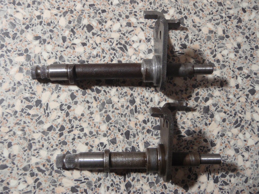

Correct me if I'm wrong, but I think there are two different types, a long and a short version.
I never tried to interchanges these, but I wonder if they would.

Post by jensen » Mon Apr 04, 2011 3:13 pm
Hi,
Look for yourself :

Post by jensen » Mon Apr 04, 2011 5:08 pm
Hi,
I presume one of these is from an early dream, like a C71 / C76, but I'm not sure on this.
In a time when I was paying less attention, I broke up a lot of CB / C engines, a few dry but mostly wet sump,and these were in the box trans parts.
I am re-arranging stuff, the last few weeks and I remembered these,
