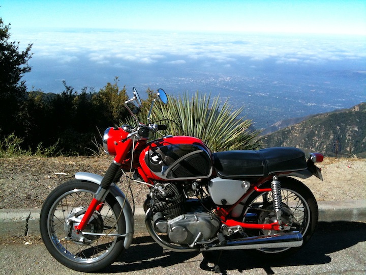

Dick,
Thanks. The picture was taken at the Mt Wilson Observatory, where the red shifts were first measured to validate the Big Bang theory.
I cold no find "transmission problem solved", but I did enjoy reading "the clutch center". I must say that you have more dedication, and skill as well, than I do. Am I to understand that you can stop at a red light in gear, then shift into neutral while stopped?
If so, congratulations! I'll relegate my tip about shifting to neutral while rolling without disengaging the clutch to the lazy and/or cheap among us.

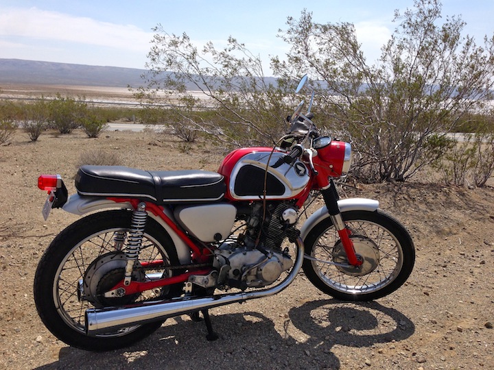

Picture below shows the same bike cooling off after advanced timing melted the right sparkp plug electrode down to the ceramic on the long climb to Randsburg (CA, not SA).
