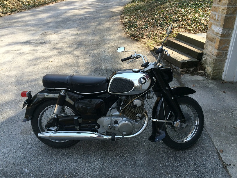

Yeah, good question. I have a '66 CA78, pictured below. Is this the correct clutch cable routing? Thanks.

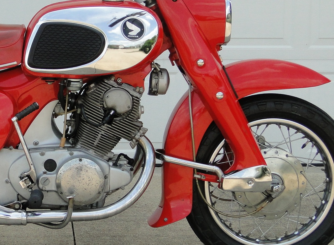

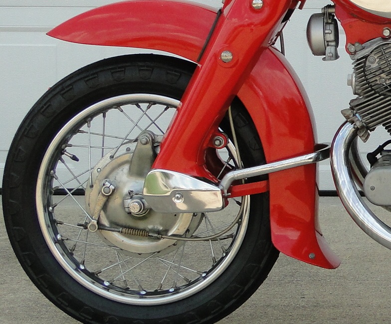

No, I think your cable is too short. It should go around the steering head as you have it, but then between the tank and frame, above the steering lock and tank mount, and come down around where the petcock is. The front brake cable on the other side looks a little out-of-whack too but I can't see it too well. Speedo cable looks good. Here's how I think they go...

Post by garncarz » Mon Apr 14, 2014 11:27 am
I rerouted both the front brake and clutch cable per the pictures above. Thanks for the advice.
