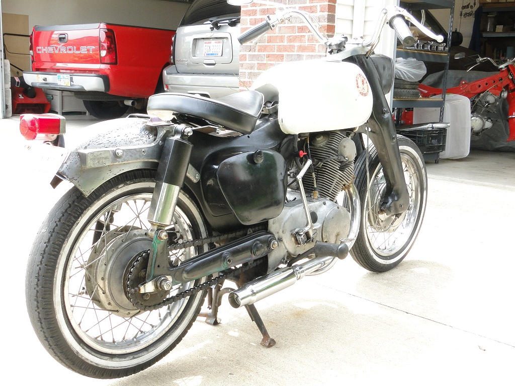

Are those stock handle bars? They look a bit cooler than normal.
48lesco
Posts: 721
Joined: Tue Mar 06, 2007 1:45 pm
Location: Olmsted Twp, Ohio
Post by 48lesco » Tue Jun 11, 2013 9:29 pm
Thanks - Those are OEM bars, just cranked back a little. The early CA77 tank and solo seat also give it a distinctive look. I'm still looking for a left side cover, the battery is naked on the other side...
