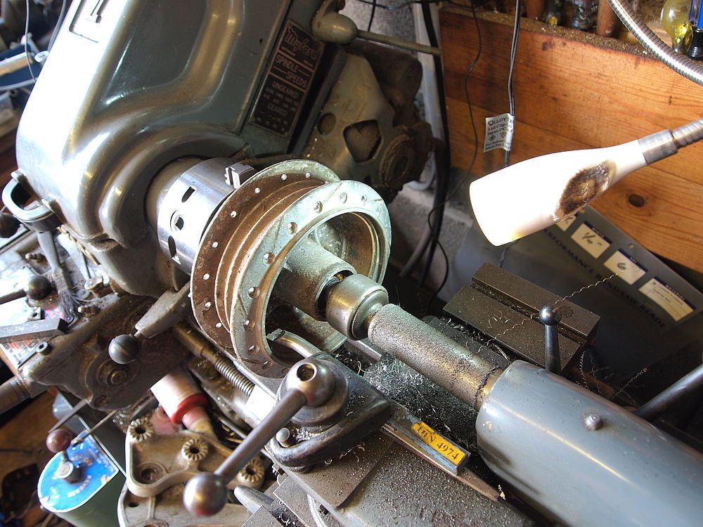

You could either try and get the drum skimmed or buy another hub. I managed to mount my CL77 hubs in a lathe and clean therm up but you do need a pretty large machine to do it in. A good brake shop or machinist should be able to fix it for you. You can get some new brake shoes and have the diameter turned to suit.

There are some shops that can mount the whole wheel and with flimsy pressed steel drums (old British bikes) this is preferable as it ensure the drum is still round when laced up.
The Dream hub is pretty stiff so I just work on the hub and re-lace afterwords.
The picture is of an S90 hub which I managed to fit in my own lathe.
