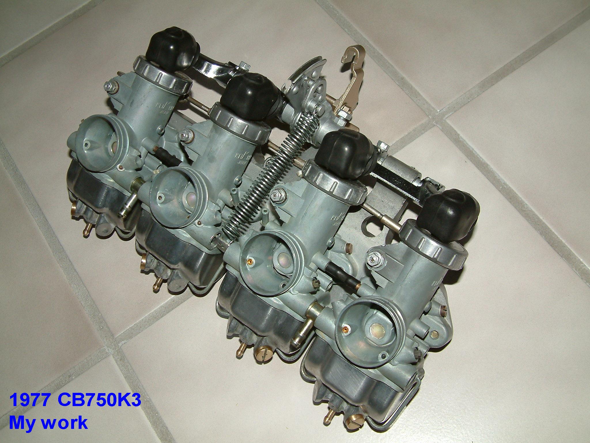

For Sale, I agree....I just trashed the pods on mine for stock airbox (slightly modified) and a K&N. It already runs smoother and I haven't even re-jetted it yet Photo shows 1977 K3??, but they do look good! 66 dream, 78 cb750k, 02fz1, 09 wing
