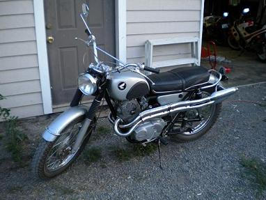

What I'm riding (when running): 1966 (mostly) CL77 305 Breather hoseYou can go either way, I used a 4" or 5" piece to get it out of the way of my cam chain adjuster. I think stock they did go to a tee. Mines' a rider not a show bike.
