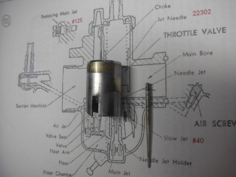

Started working the problem over the phone with LOUD MOUSE this afternoon. G-man, LM confirms what you said. Should be able to fix with jets and settings. First we went over the things that I had already checked (float level, cable adjustments, etc.). Then he had me properly adjust the idle air screw and raise the needle setting. I'm to ride it tomorrow and let him know how it runs then he'll decide what to do next. Attached a couple of photos for grins.
